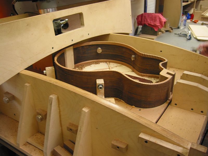

I found this on the 'bevelsnob' page, and thought you guys might be interested in it.
It's the fixture Kevin Ryan uses for cutting the arches in the sides/headblock/endblock/kerfing to accomodate the back.
There's is also a video here (under "radiusing the sides") of the fixture in use.
I like the use of the magnets to hold the body in position.
russ38684.3250115741

Very nice! Thanks Russ!

I have an old Guitarmaker that has a bunch of Kevins jigs in it, he has an amazing mind for this stuff. Sure would love to see him here!
